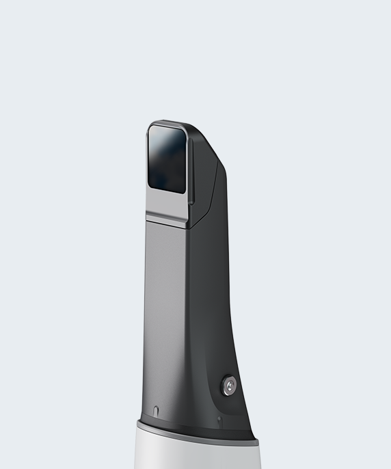

In working principle, an intraoral scanner is a camera. Like a camera, it bounces light off an object. The scanner’s lens then redirects the light back to a sensor, a single point to create a sharp image. With these images, it builds a dental model.
An intraoral scanner does this just like a digital camera, but it does it by taking images at incredibly fast speeds while crunching enormous amounts of data. Then, to top it off, the scanner and software stitch together the thousands of images to create a 3D image of an object, which also includes color information.

Without giving away any trade secrets, like a camera, TRIOS has lenses in it. And like a camera, the lens system can focus on different distances. The TRIOS scanner focuses in and out automatically. At the same time, there is a scale that the focus lens is riding on that tracks its position while it moves back and forth on the track. So, for every image taken there is also a corresponding position, and it can calculate a depth associated with that image.
So, when an image is shot, the camera knows that the lens was in this position to get this image in focus and in the next image it was in that position to be able to focus on the image. All of a sudden, we are measuring and comparing depth between the two images.
