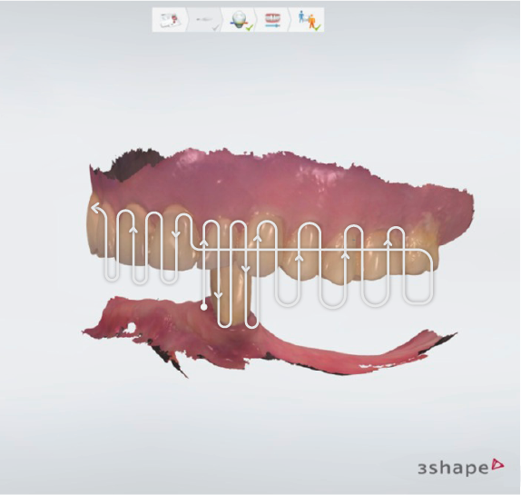

  2. Visualise and establish a path: It’s important to visualize the path that you intend to follow as you cross the midline of the patient’s mouth. If for example, you have a case with all the upper anteriors standing (in natural or artificial dentition) and no lower anteriors are present, but you do have premolars present (say 34,35,44,45 are standing). In this instance, I would use the upper dentition to bridge across the midline and make your way to the next proprioceptive contacts points.
  3. “Don’t stop ‘til you get enough”: Let those Jackson five song lyrics play in your mind once you push that scanner button to record a bite scan. When you have crossed the midline, do not push the button, and cease your scan. Keep the scanner running as you take it out of the mouth and reposition your hand/body posture and get ready for continuing the bite scan from a reference point across the midline. Around two years ago, the finding of a re-reference point to continue the same scan was quite tricky. It appears that the later software updates have made this much easier.
  4. Follow the crowd: Last point to note is every complex bite is different. Always start where there is the most natural tooth-to-tooth contact. If it’s only one tooth in the 33 position occluding with a full upper denture, then that becomes your midline and you will need to record the left and right side of that point in one go. I have included a complex case along with my bite scan path in order to give you some inspiration on how I recorded this impossible bites. No two bites are the same so learn these principles and then forge your bite path to success. Be fearless!
