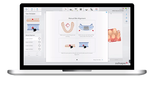

TRIOS support tip 4: Achieving the best occlusion alignment results
A correct bite registration is a critical part of scanning, especially if you are performing restorations for the patient.
You will find the general procedure for bite registration clearly described on 3Shape Learning & Support.
But here I will give you a few words of advice on the procedure:
  • Follow the instructions for all types of restorations, as described in the video on 3Shape Learning & Support.
  • Follow our instructions for scanning the bite.
  • Start the scanning on the most posterior molar.
    Manual Bite AlignmentWhen you have scanned correctly, the upper and lower jaw scans will snap into place to show you the bite.
  • If the jaws do not snap into position automatically, this is how to align them manually.
  • Scan at least four teeth, even if the jaw scans snap into place before.
  • During scanning, the bite should be taken in the optimal position, there should not be any movements, and the jaws should be fully closed.
  • Trim the retromolar pad after the last molars, not leaving too much tissue, as it may interfere when the two jaws snap.
  • Do not scan the front teeth in the bite scan unless it's the only teeth present on the jaw.
  • Ensure scan accuracy by using the recommended scan strategy and trying to avoid any holes.
  • Ensure you capture enough gingiva—at least 2-4mm—as this gives the scanner reference.
  • If the patient misses a lot of teeth, use the provisional restorations to scan the bite, or use small cotton balls to imitate the teeth.
  • If you have a pre-preparation step where you scan the original tooth before preparing for the crown, register the bite and then scan the prepared tooth.
  • Remember to follow the general guidelines: remove extra saliva, avoid direct external light, clean the scan tip mirror and front tube glass, and pre-heat the scanner to avoid fogging.
  • Have “Adjust for contact” switched off, except in cases with periodontally compromised patients and dentures.
If needed, you can always re-align the scans. With the Clearance tool, you can check your patient's contacts and the distance between the two jaws, and double-check if any further steps are required. You may also want to add another scan, reflecting the patient’s jaw movement and dynamic contact points, by pressing Add Motion Scan.
