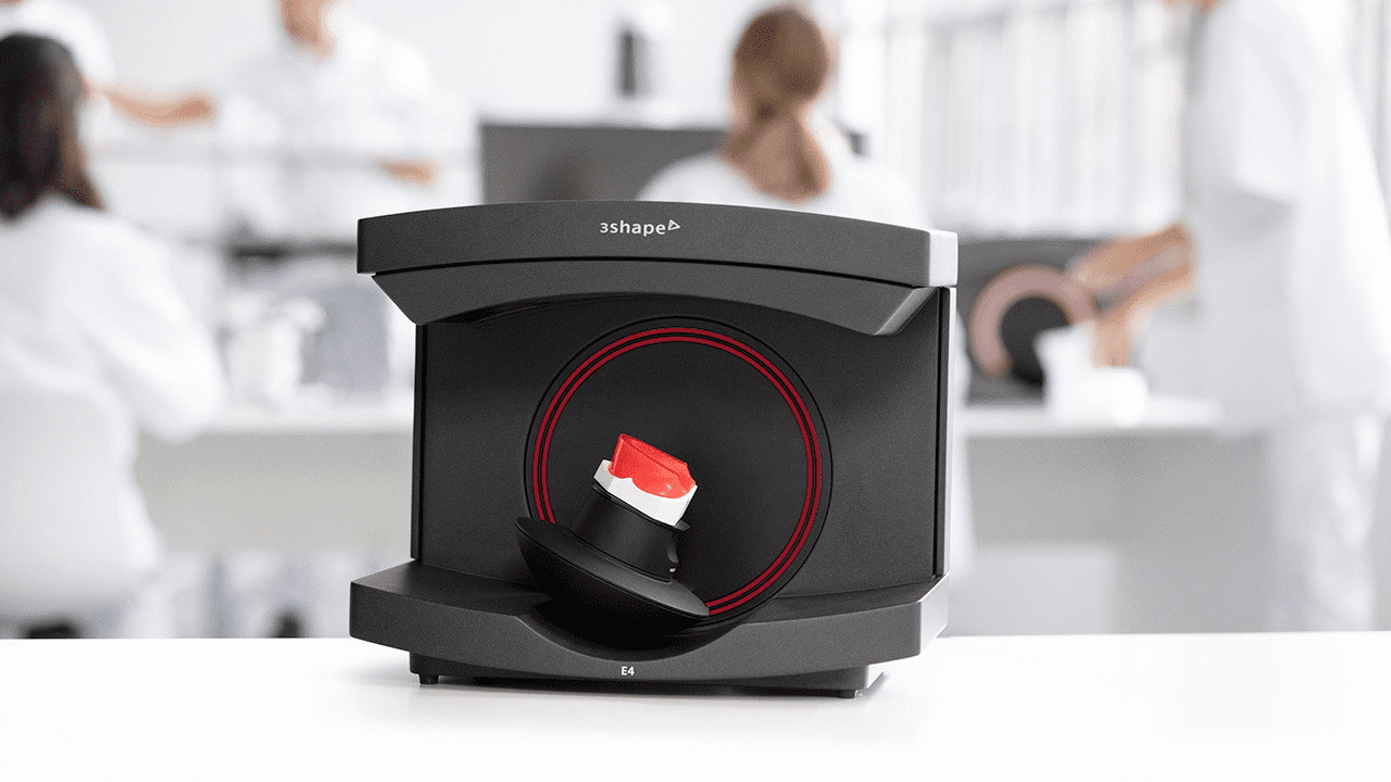

A dental laboratory scanner, also called a dental model scanner is a desktop scanner that allows dental technicians to simply place a model (or die — a small model of the crown or root surface of the tooth) inside it, press a button, and the scanner generates a 3D model. Usually 3D scanners for dental models are sold as a bundle with a software package that lets the dental technician start design and production right away. This is also called CAD/CAM dental software: the dental lab utilizes computer-aided design technology.

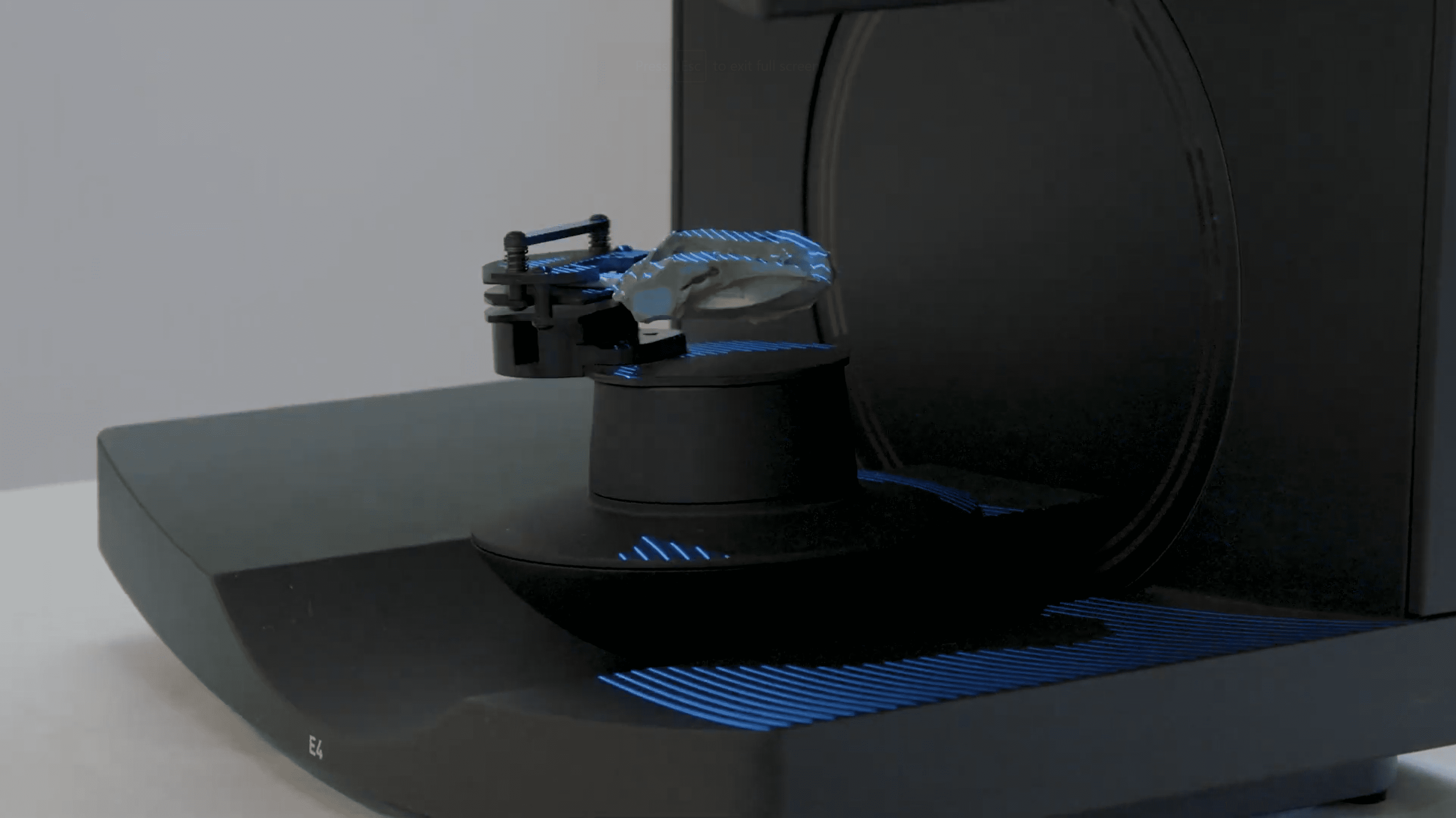

The way the scanner works is by simultaneously projecting light onto the scanned object and capturing an image of the object with on-board cameras. Combined, this will generate a 3D model of the object right away.
Some scanners use laser light, but nowadays most scanners use structured light. Using structured light is generally seen as more practical, because it allows for an open scanner, which is easier to operate. The dental technician doesn't need to open and close the scanner but can just place the object on the holder and the scanning begins automatically.

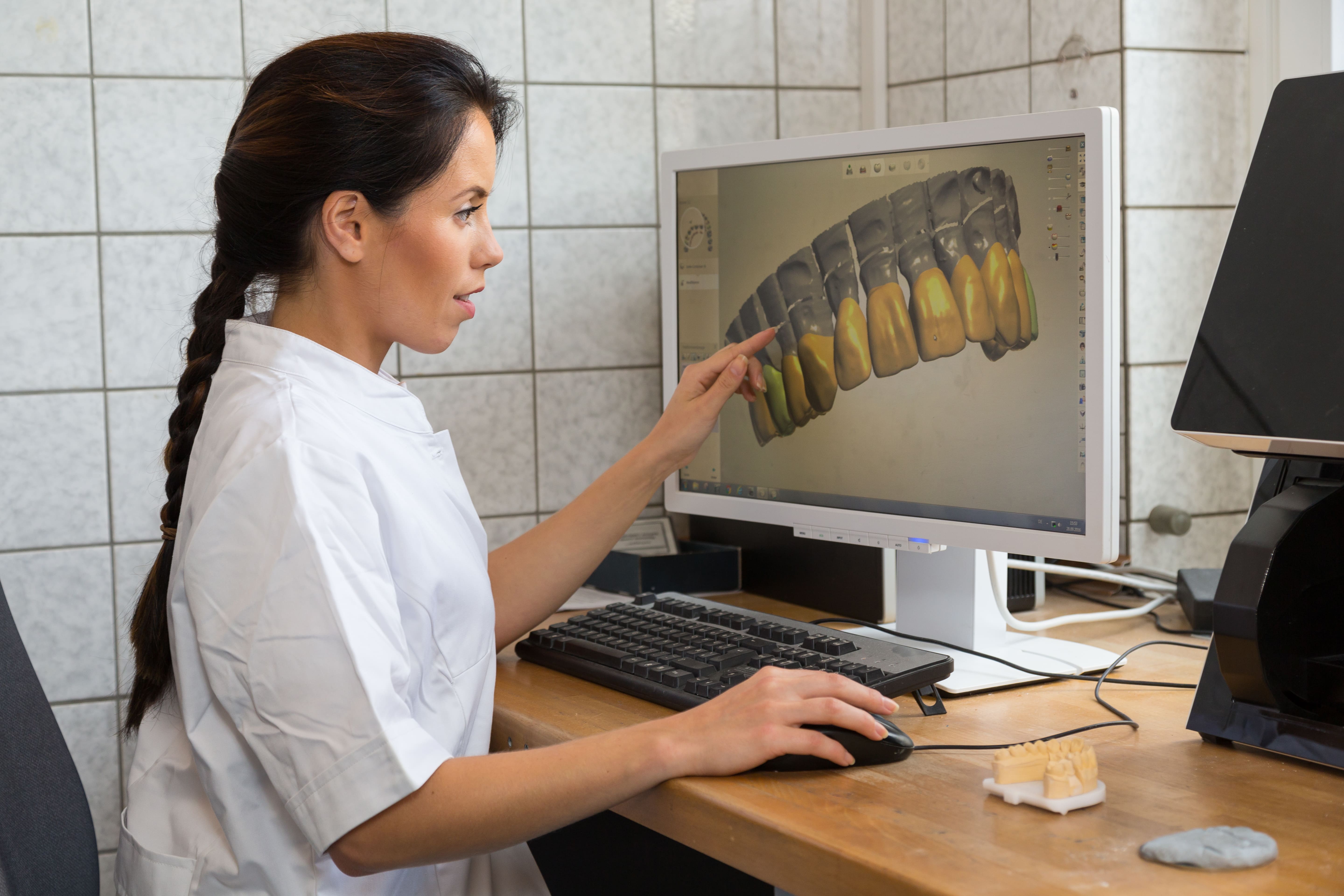

A 3D dental model scanner cannot work on its own. It will always come with some form of scanner software to -at a minimum- display the 3D file on screen and generate a dental project from it. In addition, dental technicians that design digitally, need access to a CAD solution that enables them to work on the file, and design the restoration, for example. Some scanner providers sell their products as a bundle: you buy the hardware and that comes with (a variation of) dental design software. An additional benefit of this is that you can often advertise your lab to their intraoral scanner users.
Other scanner providers sell their scanners as standalone items and in these situations, the dental lab needs to decide for themselves which CAD solution they want to work with. Another thing to keep in mind when assessing software options is how well the lab scanner integrates with other parties: it can be beneficial to ensure that your software can not only import your own scanner output, but also work with STL output or third party scans such as intraoral scans from Sirona, Planmeca or Carestream, even if you’re a 3Shape user yourself.
