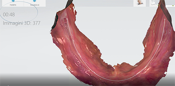

In my workflow, we begin with an intraoral scan of the edentulous patient. This caused quite a stir at the symposium.
Most people believe that it is not possible to begin the removable denture workflow with an intraoral scan. They believe that even if it is feasible, it is too difficult. Even worse, they think that an intraoral scan is not accurate enough to design dentures from.
Over the past three years, my colleagues and I have been doing research and demonstrated that concerns over the use of intraoral scans for removable dentures is in fact, not evidence based.
We have not had any problems capturing data using intraoral scans. Our work demonstrates and documents that intraoral scans are feasible and accurate enough for dentures, at least or as much so as conventional impression procedures.

Scanning an edentulous arch is much faster than waiting four minutes for conventional impression material to finally set. For us, on average, it takes about one minute to scan the edentulous maxilla and even less for the mandible. Of course, there can be variations from case to case or the patient. But on average it is much faster with an intraoral scan and more comfortable. In addition, you need fewer appointments. - See Dr. Lo Russo’s video of him TRIOS scanning an edentulous maxilla in 28 seconds.
If you compare it to a conventional workflow, you first need to make an intraoral scan to create the custom tray. Then with the custom tray you need to take the conventional impression and after, scan that. There’s really no reason to do all of this. We just start with the intraoral scan of the edentulous arch.
